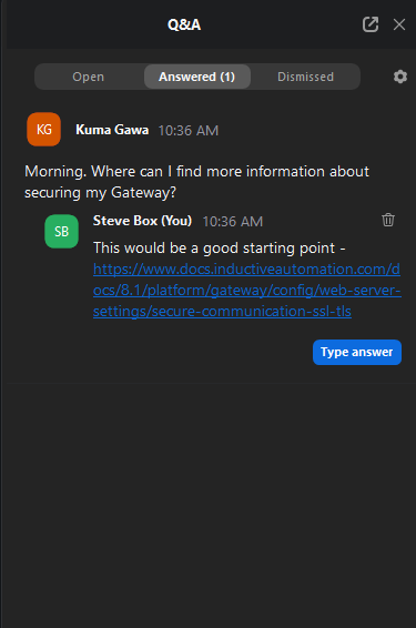

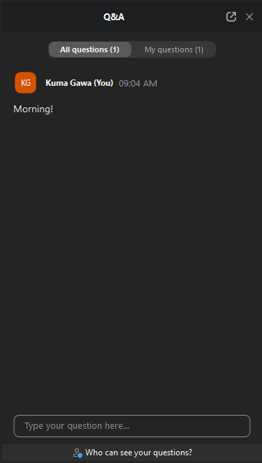

How do I communicate with the instructor?​
Due to the class size, speaking out loud to the instructor 1 on 1 during class is not an option for students. To communicate with the instructor, you must use the Q&A panel available on the Zoom control panel.
Zoom QA Panel
If you do not see the Q&A panel, click on the More icon at the bottom of the window and select Q&A.
Zoom QA on More
If you would like to pin the QA icon to your toolbar, right click on the QA icon and select Pin to taskbar.
Zoom Right Click on QA
All questions you ask in the QA panel will be private unless the instructor answers the question publicly.

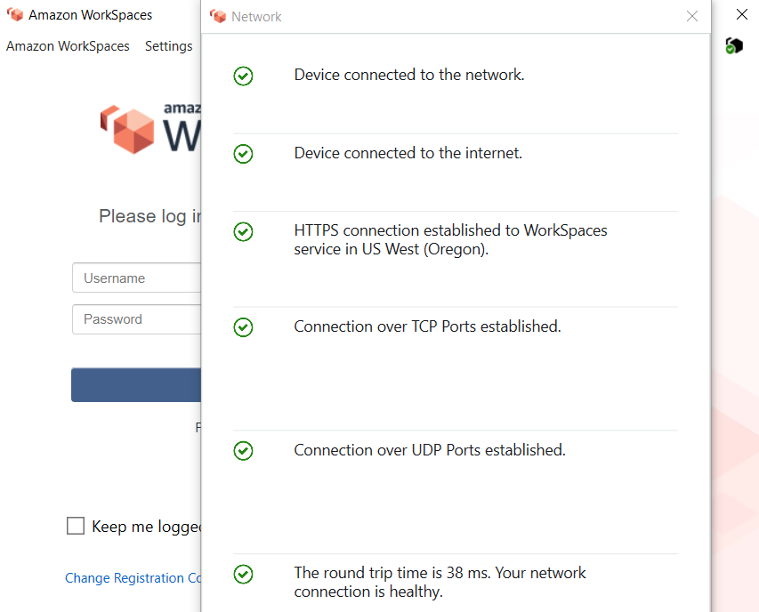

How to troubleshoot an AWS Workspaces connection?​
Generally there are 4 things to look at if you cannot connect to the Workspaces VM:
  • Review the Workspaces client connection preview (located at the top right corner of the AWS login window)
    You can click on the hexagon icon in the upper right corner of the AWS client to see network status. If any of the items in this list do not show a green checkmark then you will need to address those issues first.
  • Check your internet connection
    If your internet connection is slow or inconsistent, it will negatively impact your experience. We recommend moving to an ethernet connection if you are on WiFi, or changing locations (in the room or to another facility) to have a faster connection.
  • Verify your network rules
    If the issue is your firewall, you will have to contact your network administrator or IT group to get access. Generally, you only need to open Port 53 (UDP), Port 443 (TCP), Port 4172 and 4195 (UDP and TCP).
  • Try disabling any VPN connection before attempting to connect, or try on another network entirely if available.
